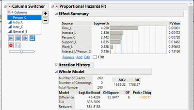

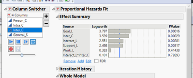

I'm not exactly sure what is the question. My example seems to be working fine (or I might be missing something)
Names Default To Here(1);
dt = Open("$SAMPLE_DATA/Job Satisfaction.jmp");
obj = dt << Fit Model(
	Y(:Satisfaction_Avg),
	Effects(
		:Support_L, :Goal_L, :Work_L, :Interact_L, :Person_C,
		:Interact_L * :Person_C
	Personality( "Proportional Hazard" ),
	Emphasis("Effect Leverage"),
	Run(
		:Satisfaction_Avg << {Summary of Fit(1), Analysis of Variance(1),
		Parameter Estimates(1), Scaled Estimates(0), Plot Actual by Predicted(1),
		Plot Regression(0), Plot Residual by Predicted(1),
		Plot Studentized Residuals(0), Plot Effect Leverage(1),
		Plot Residual by Normal Quantiles(0), Box Cox Y Transformation(0)}
col_switcher = obj << Column Switcher(
	:Person_C,
	{:Person_C, :Intra_C, :Inter_C, General_S}
-Jarmo
