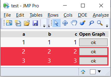

I have a table box that has text but also buttons and I want to color it it more then 1 color

The problem is that if I remove the last 2 lines, it colors the last 2 lines in red, but if I do run the last 2 lines, it removes the red color and colors in green the top line instead of leaving the red color as well
before running last 2 lines:
after running last 2 lines
is there a way to color the table box in more then 1 color? (I want it to have both red and green colors)

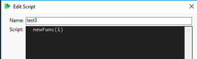

I have 1 last question:
using this code, I'm trying to create for each button a different value in the function.
so in this example if I click button 1 it should print 1, if I click 2 it should print 2 and so on..
but for some reason the value doesn't "stick" and any button I click it says 4.(4 is the number of i after the loop ends)

is there a way to fix this?

You can easily check what is the issue by using Set Script on one of the buttons from the window that opens:
i is the argument when it should be the number. You could go with Eval(Parse()) way to fix it:
For( i = 1, i <= 3, i++,
	Insert Into(bblist, Eval(Parse("buttonbox(\!"test"||char(i)||"\!",newFunc("||char(i)||"))")));
Or Eval(Eval Expr()):
	Eval(EvalExpr(Insert Into(bblist, buttonbox("test"||char(expr(i)),newFunc(expr(i))))));
You want the Set Script to look like this (at least in this case):
