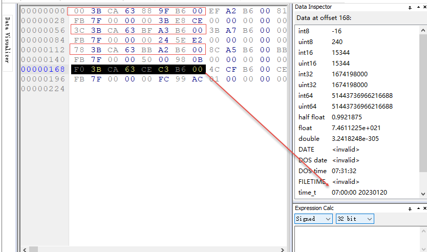

How does this binary file restore the correct time of year, month and day?
This file has four lines of data, and the first eight bytes of each line are the year, month, and day data

You've got two big hints in the work you've already done: an actual date, and the code time_t. Time_t is a Unix thing. Lets try a tool like epoch converter, and push the date you know into it:
the red number is what we wantthe red number is what we want
Hey! that number also appears in your data inspector! It is an int 32! That means we can load your data like this:

The Unix epoch begins on 1Jan1970, which is 0. The JMP epoch begins on 1Jan1904, which is 0. Adding JMP's 1Jan1970 value to a Unix date converts the Unix date to a JMP date.
The blob to matrix call makes 14 4-byte numbers per row; the subscript [0,1] means 0: keep all 4 rows and 1: keep the first element on each row.
