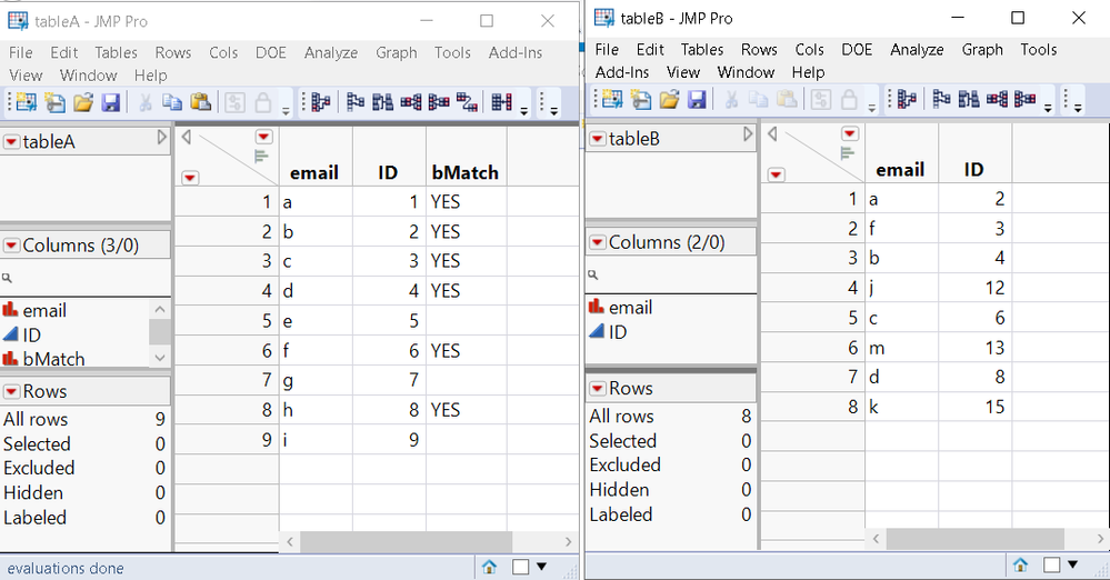

Hi, if I interpret your question correctly, you want a YES in table A whenever the e-mail or ID appears in B, regardless of the location in which these appear in table B. If so, this will do:
Names Default To Here(1);
dtA = datatable("tableA");
dtb = datatable("tableB");
//make lists of IDs and emails in table B
bIDs = dtB:ID << get values;
bEmails = dtB:email << get values;
//use formula to check if anything in the given row of A occurs anywhere in B
dtA << new column("bMatch", character, formula(if(contains(bIDs, :ID) | contains(bEmails, :email), "YES", "")));
dtA:bMatch << Delete Formula;
Here is sample output:
Cheers,
Brady

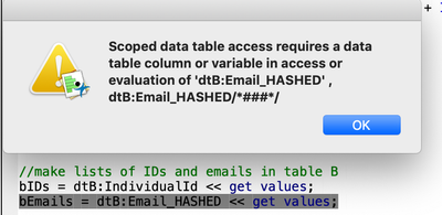

I have one error with this script. Wonder if it's because there's an underscore within the col name?
jthi
Re: check if data exist in another table
To my understanding _ shouldn't cause issues (at least not with JMP14.3 and JMP15.2). Are you sure you have  Email_HASHED column in your dtB datatable?
-Jarmo
joann
Level IV
Sorry my bad! Wrong column name, i fixed it and it worked! Thanks so much!
