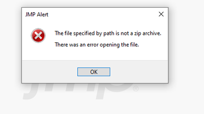

all of a sudden i can't access the files in a JMP project i've been using for a long time.  the project itself opens, but then this "JMP alert" pops up and i none of the files saved in the project appear...has anyone else encountered this before???
i am using JMP 16.1.0

Luckily, a JMP developer saw my issue on this discussion thread and told me to send the bad project over to JMP.  He was able to locate a corrupted data table in the project which was causing this fault.  when he deleted the corrupted datatable, i could open the project again.   Possibly one of my data tables in the project got messed up during an unexpected reboot.

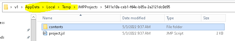

You should also peek here and see if there is an abandoned project you might get something back from:
temp dirtemp dir
Don't hold your breath; if you find anything it probably is incomplete or old.

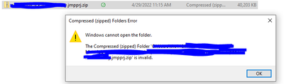

the JMP project in the file explorer still says the file is 40MB, about what i remember it being when i last opened it
i tried renaming the project with a ".zip" extension, but file explorer wont let me open the renamed zip file

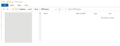

when i open the JMP project in question and check the "JMPProject" folder, i don't see anything appear.  when i open other projects, i see the contents file appear

sorry, here is a better pic of the JMPprj in the folder
