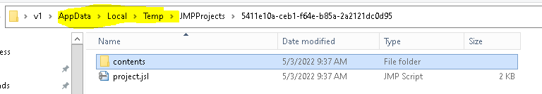

A JMP 15 project will open with notepad and looks like this
/* JMP 15.2.1 */
New Project(
	Run Script(
A JMP 16 project is zipped, and if renamed looks like this
You should also peek here and see if there is an abandoned project you might get something back from:
temp dirtemp dir
Don't hold your breath; if you find anything it probably is incomplete or old.
