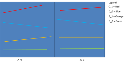

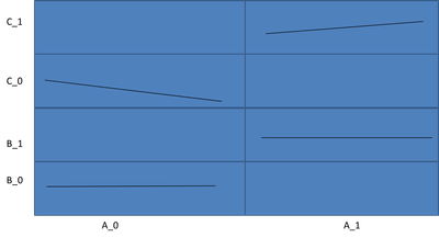

I have 6 columns: A_0, A_1, B_0, B_1, C_0, and C_1. Each column contains multiple values. I want to create a graph with 4 linear lines.
  • All values from A_0 and A_1 should be on the same x-axis.
  • All values from B_0, B_1, C_0, and C_1 should be on the y-axis.
Why 4 linear lines?
  1. A_0 with B_0 (first line)
  2. A_0 with C_0 (second line)
  3. A_1 with B_1 (third line)
  4. A_1 with C_1 (fourth line)
Do you have any suggestions on how to do this?

*Many ways to create through Graph Builder. How do you want to see it ?
1) Stack Y-Axis
2) Overlay Y-axis
3) Stack Y-axis (mute the color of unwanted lines)
Anyway, you need to tick "Row order" to display all raw Y-values
If you can draft the visual of the output, it is much easier to help.
