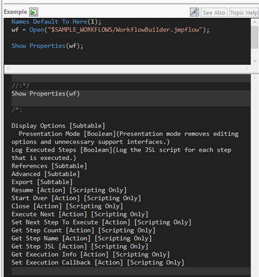

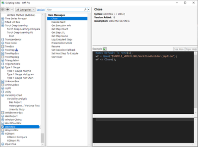

If you check scripting index for Workflow it is very limited
You can also check if there are any interesting commands using Show Properties on the workflow object
Some of these (like usually...) are not documented in scripting index but I would guess that none of these do what you are looking for. You might be able to write your own custom JSL to perform the actions you are looking for but it might require quite a lot (at one point I did start custom workflow script to allow for better report flow report creation but I never finished it). I would hope that JMP will make workflows easier to script in some future version of JMP.

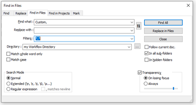

The .jmpflow files have an easy structure, maybe I will add the changes there ...
hogi
Level XII
Re: automate Workflow Builder - add Workflow Step
on my way - a helpful change:
There is limited JSL to use with the workflow - those steps were added so you could open workflows and run them if you had maybe an automated script daily.  Workflow is not really designed to be a JSL script that is written and added to - if you can do that, you can just write the JSL and use a script.  If you are an advanced scripter, you can add custom steps to the workflows, but the workflow is to automate your runs, and also really valuable to assist those that may not know scripting or like to write the script themselves.

What command can I use to run the workflow?
Names Default To Here( 1 );
wf = Open(
	"$SAMPLE_WORKFLOWS/WorkflowBuilder.jmpflow"
wf << Resume();
Resume will execute or resume execution
