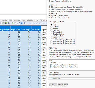

There are other ways to do this, but check out the recently-posted Scripting Tools Add-in, if I understand your request correctly you can select all of the columns you are interested in (start with a couple to make sure it works as expected) and enter this in the formula section:
Abs(
	Col Sum(
		(<column> / Col Sum( <column> )) *
		Ln( <column> / Col Sum( <column> ) )
) / Ln( Col Number( <column> ) )
Abs(
	Col Sum(

This works perfectly. Thank you.
