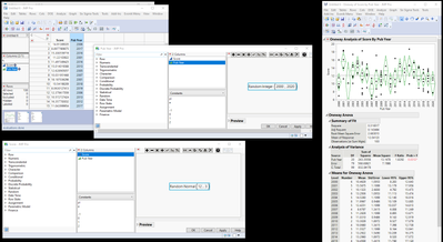

  In the below example, I created a fake data table with a column called score, which is a random normal number with mean of 12 and stdev of 3 and a publication year which was a random integer from 2000 to 2020 -- just to give an idea. Then, you do a Fit Y by X and cast Score as Y and Pub Year as X, and then You can do an ANOVA analysis of Score by Year (click on the red hot button next to Oneway... to get your statistical options to review). Be careful to be sure and understand the kinds of tests you need to be aware of for the ANOVA, and don't just take the output it gives as telling the whole story.

Thanks for the great replies.  My data are structured the same as your "fake" table.  The main difference between your data and mine, is that in mine "score" ("count in my table) is an integer count with a defined range of zero to 24.  The counts are closely clustered near the top of the range.  I didn't think ANOVA would be a good choice because the data are discrete and not normally distributed.
