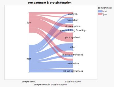

Another possible visualization would be the parallel element:
coral protein breakdown - Graph Builder.pngcoral protein breakdown - Graph Builder.png
Graph Builder(

abmayfield
Level VI
Re: alternatives to pie graphs for proportional data
Wow! Now this is the reason I post these sorts of (seemingly mundane and trivial) questions: that's a type of plot I didn't even know you could make in GraphBuilder! It may not be the "winner" for this particular dataset because I think it's not the simplest (though arguably the prettiest), but I regularly have a need for this sort of graphic display with other datasets, so this is great. I literally never clicked on the parallel plot icon in 10 years of using JMP until five minutes ago (i.e., after reading your suggestion).
