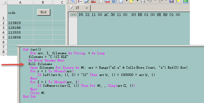

My requirement is to output the 4 data points of the table as a new file as *.blk file.The original BLK file was deleted before the output.
I re-uploaded the specific VBA Excel file, opened it and clicked the "BLK" button, which would generate a "1t. BLK" file in the path of "C:\".
The request how to write JSL code can achieve this function of VBA: the four data in the table is directly generated and VBA generated BLK file exactly the same.
Thanks!

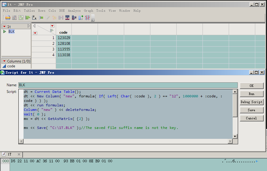

I tried writing JSL:
But I still don't know how to save the data in the table in the form of the graph.The saved file suffix name is not the key.
dt = Current Data Table();
dt << New Column( "new", formula( If( Left( Char( :code ), 2 ) == "12", 1000000 + :code, :code ) ) );
dt << run formulas;
Column( "new" ) << deleteFormula;
Wait( 0 );
mx = dt << GetAsMatrix( {2} );
mx << Save( "C:\1T.BLK" );//The saved file suffix name is not the key.
lwx228
Level VIII
Re: How can JSL modify data in a table directly to a specified binary file?
Please download the "1T.blk" file again,
see its structure, and how to save the 4 rows in the table in the form of "1T.blk".
Thank Craige!
