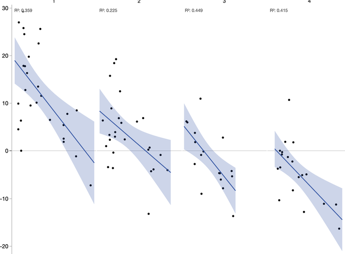

I was wondering how I can add the p value below R2. I cant find any help online how to add this. Thanks a lot !
Screenshot 2024-05-15 at 9.52.05 PM.pngScreenshot 2024-05-15 at 9.52.05 PM.png

Hi @Laraaylin,
Welcome in the Community !
If this graph comes from Graph Builder, try to select in the options for the Line of Fit (on the left of the windows) the "F-Test" value statistic : https://www.jmp.com/support/help/en/17.2/#page/jmp/line-of-fit.shtml#
