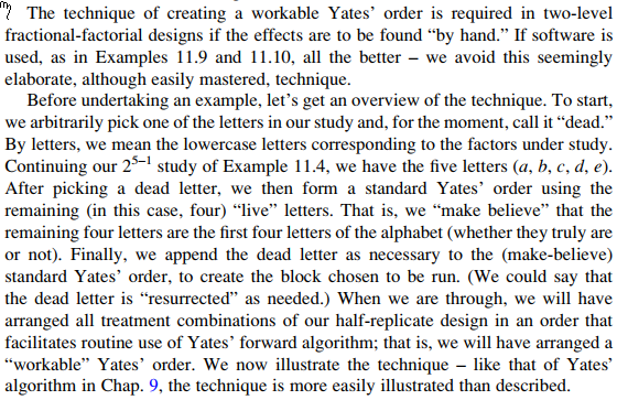

And here is another technique described by Paul Berger in his book:

Re: Yates' order in JMP
The method is linear regression.You can use JMP Analyze > Fit Model to specify the the response column and the terms in the linear predictor and then click Run to estimate the parameters for the desired effects.
Alternatively, you can send the Get As Matrix message to the data table with your design and then use the matrix language in the JMP scripting language to compute the estimates yourself.
I don't know your background but this problem is pretty standard for linear regression.

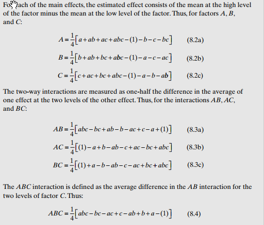

What I did for full-factorial:
1. Created Yates' Order in a design table
2. Created equations where values of (1), A, B, C, AB, BC, AC, ABC where predefined and a ab ac abc b c bc were unknown.
3. Solved simultaneous equations in order to find values of responses for each rows that is a ab ac abc b c bc.
Because I took the example where responses were already known I could compare the results and they were correct.
I thought I could use the same process for deriving responses for fractional-factorial.
