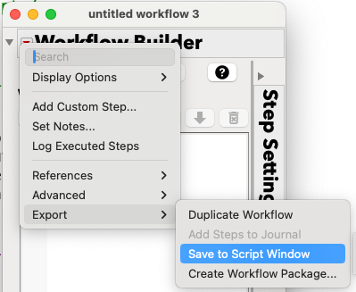

If you want to loop the workflow, maybe try saving the script for the workflow and just loop that?
There wouldn't be any animations, plus with a few tweaks you could make tables invisible or private, that speeds things up too.

As a short-term solution, replaced the for via the "Workflow" with a for loop inside a single step (see the example in the original post). This solves my issue. I will encourage all my colleagues to do it the same way.
The difference in is significant - and a bit surprising.
