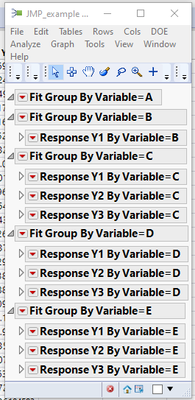

MRB3855
Re: With missing data, Fit Model platform doesn't run properly across all "by" variables
Thanks for the response. I should get results for Y2 and Y3 for By Variable A (clearly not for Y1 since the data are missing for Y1 By Variable A), but I don't. See attached screenshot. Similarly, for By Variable B I should get results for Y1 and Y3. But, I only get results for Y1.

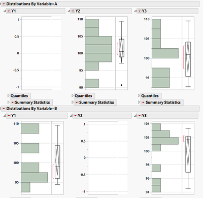

MRB3855
Further, I would expect it to work like the distribution platform does. 
