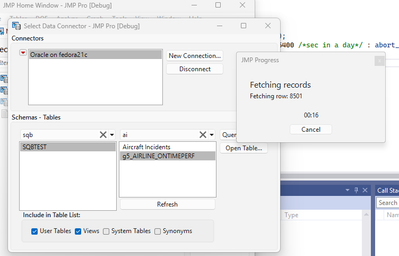

I assume you mean this one (I'm not sure if it is possible to display that when using << Run Background):
You could maybe build your own utilizing Running Queries and custom New Window where you pick the values from Running Queries window and update the custom window inside your loop.

Yes! That's the one. I don't need to run it in background, i can run foreground but even when I have it execute with 'Run Foreground' I don't get the fetching records window and it just seems like JMP is completely frozen.

Re: Window popup for SQL query that gives user feedback on #rows fetched
Running in the foreground is the way to do it.
The Fetching records progress bar will automatically pop up after a few seconds when there are a lot of rows to import.
For instance, this table is over 600,000 rows.
It should be noted that in most cases, "Fetching records" is not one record from the database at a time. In many cases JMP can retrieve say, 500 records at a time.
