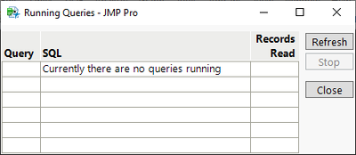

With option three you won't get as "clean" rows fetched with this but you could maybe use Running Queries window
Main Menu("View:Running Queries");

yeah I considered that but it's a bit clunky for a tool I'm building for a large team... do you know about the 'fetching rows' window I'm talking about? I somehow can't get it to pop up again no matter what

I assume you mean this one (I'm not sure if it is possible to display that when using << Run Background):
You could maybe build your own utilizing Running Queries and custom New Window where you pick the values from Running Queries window and update the custom window inside your loop.
