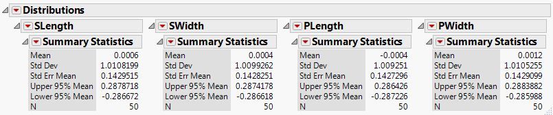

Using the data you provided, I used Distributions to look at it and got these results:
That is enough of a difference to give round-off error. Again, even if the standard deviation is exactly 1, you will likely get a constant term that is very close to zero. The scaling is what prevents everything from just being a product of the eigenvectors and the data. You are not just using the data, you are using scaled data (every time JMP will do the scaling because, as your data shows, you don't always know the standard deviation = 1). Estimation can be a messy game sometimes.
