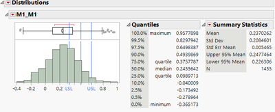

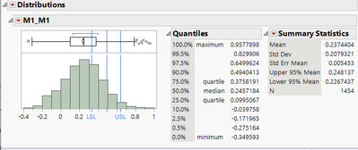

Calculating column mean before and after excluding a row is giving me same values via JSL. It is different as expected when obtained from the distribution platform. Where am I going wrong in JSL?

Distribution(Stack(1), Continuous Distribution(Column(:M1_M1 ), Horizontal Layout(1),Vertical(0), Process Capability(0)));
dt << select where( dt:colName == colMin)<< Hide and Exclude; // hide and exclude the minimim value of the column
colMeanNew  = Col Mean(dt:colName); show (colMeanNew); // get column mean again
//plot distribution again

Col Mean() does not honor the Excluded rows like the JMP Platforms do.  If you use:
colMeanNew = Col Mean( If( Excluded( Row State( Row() ) ), ., dt:colName ) );
it will give you the result you want.
