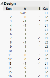

I set up the factors and model to match your requirement. I used the Default = 16 number of runs. Here is the design:
 Assuming that the real effect modeled by each term is twice as large as the standard deviation of the response, I get this power analysis:
So while the correlation is high for some parameters, they are still estimable if large enough. The correlation will, of course, inflate the variance of the estimates, as shown in the estimation efficiency:
