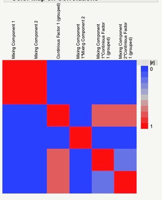

1. I have used the custom design in jmp, but when I did that I assumed only 2 continuous factors: the relative amount of the mixing component 2 and the continuous factor. Only later when I wanted to vary a third factor I realized that this must be described as a mixture, to get realistic combinations. This is why I wondered if it needs to be treated it as a mixture.
Anyway my design inputs are attached in the design picture. So 2 factors, interaction and quadratic terms. I choose 9 experiments because all terms were non aliased with that approach.

1. Unfortunately the 3rd factor you added was not added to the matrix orthogonally and therefore you ended up with confounded main effects in your initial post.
I'm nit sure I understand you logic about why it has to be considered a mixture...Again mixtures are a special case of experimentation where there are constraints on the level-setting.  You suggest there are no constraints, so you don't have a mixture problem.  A factorial problem perhaps.
