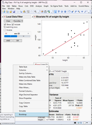

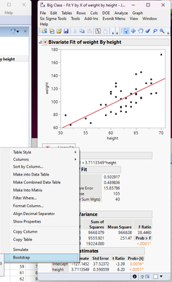

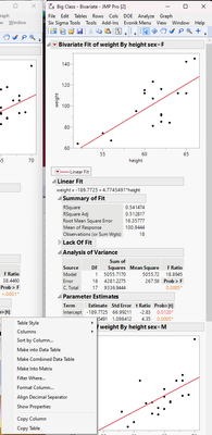

  The first image shows the first example of the regular bivariate fit. The second, when using a BY variable (and that the simulate and bootstrap options are gone when right clicking a statistic). The third shows the regular bivariate fit with a local data filter and the ability to still perform the simulate or bootstrap.
