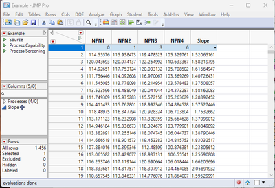

Here is an example of a way to do this, if your input data resembles your attached picture of your Excel layout.
names default to here(1);
// Create an example data table
dt =
// Open Data Table: semiconductor capability.jmp
// → Data Table( "semiconductor capability" )
Open( "$SAMPLE_DATA/semiconductor capability.jmp" );
dtExample = dt << Subset( columns(:NPN1, :NPN2, :NPN3, :NPN4), output table( "Example" ) );
// Close the semiconductor capability data table
close( dt, nosave );
// add the initial comparison slope as row 1
dtExample << Add Rows( 1, At Start );
:NPN1[1] = 0;
:NPN2[1] = 1;
:NPN3[1] = 3;
:NPN4[1] = 6;
// Create the Slope Column and add the formula
dtExample << New Column( "Slope",
	formula(
		// Create the y matrix from the 4 columns at row 1;
		// The y matrix needs to be the transpose of row 1,
		// since the matrix needs to be a 4 row matrix, not
		// a 4 column matrix
		As Constant( x = current data table()[1, 1::4]` );
		// For all rows in the data table, except the first
		// create the y matrix(transposed) and then run the
		// regression, stripping out only the slope from
		// the Estimates list created from the linear regression
		If( Row() > 1,
			y = current data table()[Row(), 1::4]`;
			{Estimates, Std_Error, Diagnostics} = Linear Regression( y, x );
			slope = Abs( Estimates[2] );
			slope = .
dt =
:NPN1[1] = 0;
:NPN2[1] = 1;
:NPN3[1] = 3;
:NPN4[1] = 6;
	formula(
		If( Row() > 1,
			slope = .
Jim

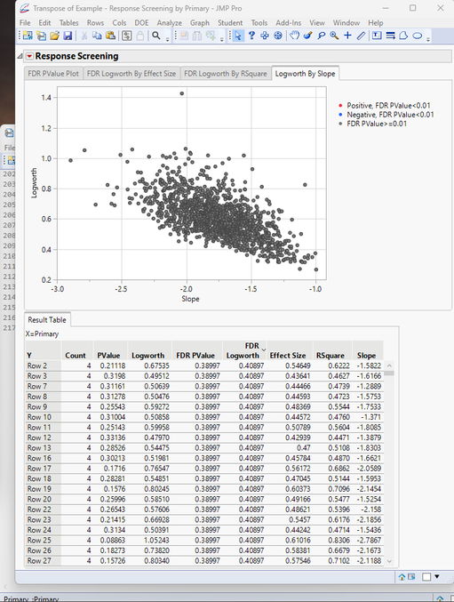

Thinking further on your request, you night want to look into using the Response Screening Platform available in JMP.  It is designed to look at a large number of analyses and to attempt to make some sense to fact that false positives can impact an analysis.
To do this, a simple transpose of your data from being row centric to a column centric shape is required(JMP typically uses column centric data structure).
The example below shows the transpose and the analysis
dt =
// Transpose into columns
dtTrans = dtExample << Transpose(
	columns( Column Group( "Processes" ) ),
	Output Table( "Transpose of Example" )
close( dtExample, nosave );
// New column: Primary
dtTrans << New Column( "Primary",
	Numeric,
	"Continuous",
	Format( "Best", 12 ),
	values([0,1,3,6])
) << Move Selected Columns( {:Primary}, To First );
// Build a JMP list to handle all of the transposed columns as
// a single reference
responseColList = dtTrans << get column names(string, continuous );
// Delete the first entry which is the new column called Primary
remove from( responseColList, 1,1);
// Run the Response Screening Platform which is designed to allow for the
// exploration of a large number of analyses
// Launch platform: Predictor Screening
dtTrans <<
response Screening(
	Y( eval(responseColList)
	X( :Primary ),
	Show Slopes( 1 ),
	PValues Table on Launch( 0 ),
	Common Y Scale( 1 ),
	Common X Scale( 1 ),
Details on the Response Screening Platform can be found in the Help Screens, or in the Predictive and Specialized Modeling document, available in the JMP Documentation Library, under the Help pull down menu

Thanks for your effort, the main purpose of my sheet that I want to do Monte Carlo Simulation to make noiseness (400 psudo data set) to the first row with fixing the time points, the excel sheet that I shared with you consists of experimental one row and 399 generated data sets, what I'm trying to say if column centric would help to generate these data kindly advise me the way to do that.
I have tried your first method and it works, but unfortunately I'm still new in JMP so now I learn JSL to understand how to make your method.
Thanks again
