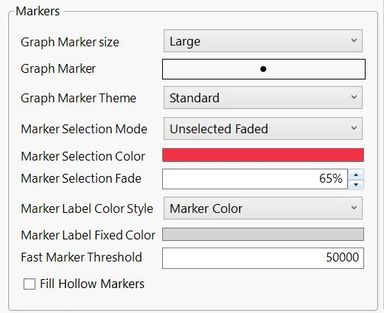

Without the picture, my best guess would be that you have enough data to enact the "Fast Marker Threshold".
From JMP Help: When the number of markers in a graph exceeds the
Fast Marker Threshold, the graph’s Marker Drawing
Mode is set to Fast. which draws dot-sized markers.
By default the Fast Marker Threshold is 50000. You can change this in the preferences (File > Preferences > Graph)

I'm having the same issue with variability chart.
Something about the Fast Marker Threshold causes the points to be very small. I tried setting it to a negative number and it helped while JMP was kept open. But the next time I closed and opened JMP it returned to 0 and I get again tiny dots.
This is a problem since it means I can't automate my script.

Why not just set the setting to a very large number?

Thanks. I didn't realize I was changing it in the wrong direction. Looks like it resolved my problem.
