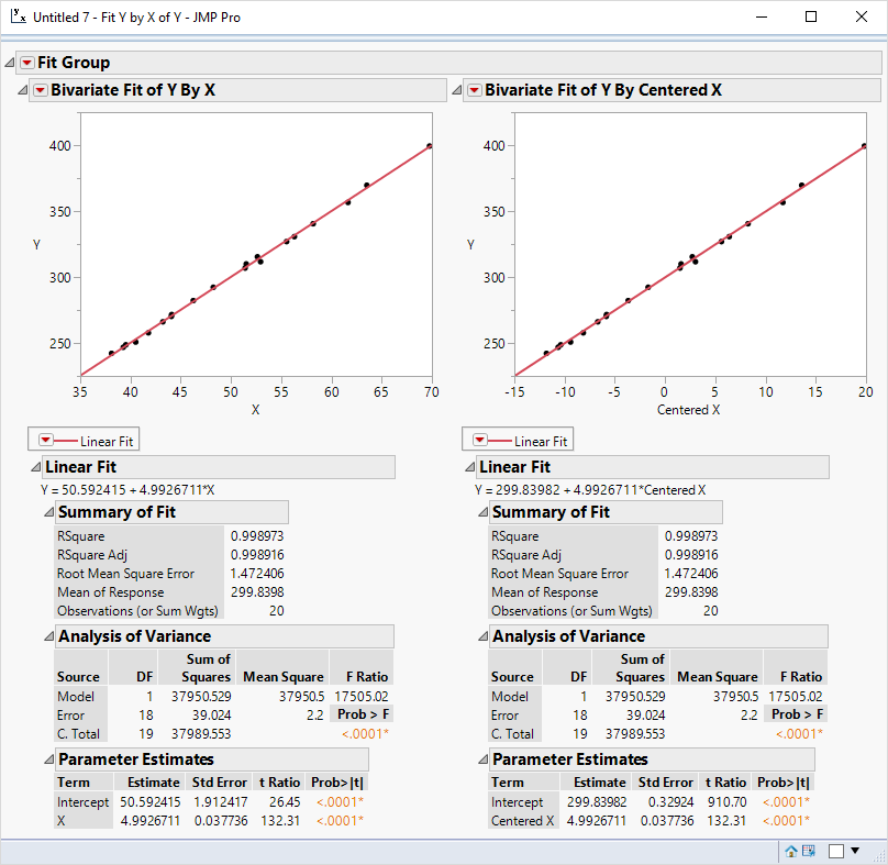

Just think about the y-intercept in this case of OLS regression where the first analysis uses X for the regressor and the second analysis uses X after centering:
So the intercept is not generally equal to the mean response but it will be if you center the predictor variables and use the identity link function.

The intercept (specifically, the y-intercept) is the constant term in the linear predictor (linear combination) used in ordinary least squares regression, generalized linear models, and generalized regression (JMP). It is generally the value of the linear predictor when all of the predictor variables are set to zero. It is not generally the mean response. That result depends on predictor values in the case of OLS regression. In the case of GLM, it also depends on the link function. If you want the intercept to be the mean response, then you must center your predictor variables and use the identity link.

Hello Mark,
I figured I'd get a quick and insightful reply from you.  Thanks.  I hadn't thought about the aspect of centering the X's.  I was explicitly doing centering (and scale normalization) because I am applying LASSO to a logistic regression problem for feature selection.  I can see that now if I don't center the design matrix I get a different answer.  When it's centered, the intercept is almost exactly the link function applied to the mean response (fraction of positives).  Very cool.  The problem got me thinking about the picture I would present for LASSO shrinkage because the response space is now the corners of the unit cube.  Add to that the optimal solution shrinks toward some point in the interior exactly equal to the mean response (times (1, 1, 1, ...)) as the penalty increases.
