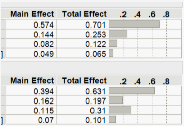

I'm analyzing a DoE and had a look on the variable importance graphs. Surprisingly, the sum of the total effects of my parameters are greater than 1 sometimes (see picture below).
I did not find anything in the documentation for this. Can someone explain, why the sum of the total effects can be greater than 1?

These indices are used for assessing the relative importance. Neither the main effect indices or total effect indices are constrained to sum to 1.
See the statistical details here.
