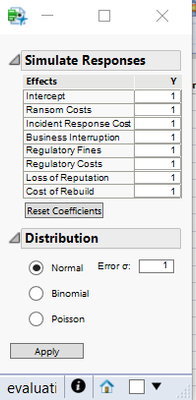

The simulated data have nothing to do with the original Total Cost data. The simulated data depends entirely on your definition of the model parameters. Here are the definitions you used:
I would expect the simulated data based on your definitions.

Why would you expect the simulated Total Cost values to be between 64.08 and 126.12? The simulation parameters determine the simulated values in the data table column.
You entered those values in the definition of the response. They are saved as the Response Limits column property. The simulator does not use those values. The Prediction Profiler uses those values when you optimize the response using the fitted model. They represent the range of outcomes that are acceptable to you. You defined this Total Cost to minimize it. So if you achieve a response of 64.08 or lower, the desirability equals 1. If you achieve a response of 126.12 or higher, the desirability is 0. The desirability is between 0 and 1 when the response is between those two values. That is what your definition means.

This table shows that regression coefficients are all equal including the intercept.

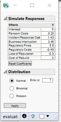

I tempted to run the model by setting Intercept = 0 and changing the regression coefficients depending on my own choice of effects of independent variables on the dependent variable (where Regulatory Fines assumes to be largest impact on the response variable i.e., Total Cyber Cost).
I have shown it in the below figure (for example)
However, when I hit “Apply”, I do not see any output.
Question 1: What is the purpose of this window in the DOE exercise?

Answer 1: The simulated responses appear in the data table you made. There is a data column for the response. You use this column to enter the actual experimental results for analysis. There is another column next to it populated by the Simulate Responses dialog. It is populated every time you click the Apply button. You can copy the values in the second column and paste them into the first response column for analysis.
Answer 2: The Total Cyber Cost column is populated by you as you run the experiment or initially by the simulator. When you click the Apply button, the Total Cyber Cost is populated by the Simulate Responses dialog. I don't know where the Y Simulated column came from. I would expect it only if you did not change the default name (Y) in the response definition in Custom Design.
