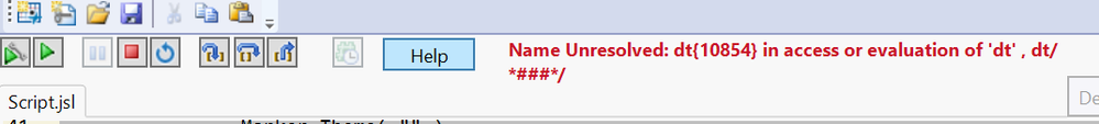

However, I encountered another problem with this:
Is there anything wrong with my definition in the script ?
dt = open("Monitoring.jmp", invisible);
Close( dt, save ("C:\Users\Testing") );
Thank you,
Ann
txnelson
Re: Why am I unable to save my variability charts automatically in a script ?
The syntax of the code you have specified is correct.  However, I can not verify that your "Monitoring.jmp" data table is available in the default directory.
Jim
