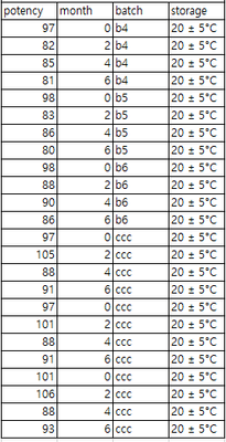

I was trying to analyze the stability test data.
with SCRIPT which was attached in upper Link.

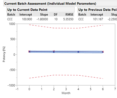

However, the PI(Prediction interval) is extremely wide as it is seen as following picture.
I have no idea why this happen.
Please be aware that if more month of observation is added, PI range drastically reduces.
i.e. add 2 more mont

Did you step through the script to see why the interval is so wide? Did you read the reference articles that might discuss the nature of the interval and what to expect?
Did you contact the author of the paper that you cite?
