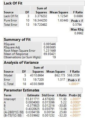

When I change the terms in the model, DF of pure error in the LOF test also changes. (10 to 14)

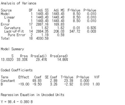

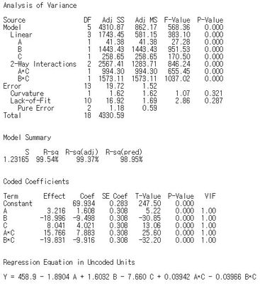

In Minitab it doesn't change with the change of the model (same DF = 2 for 3 replicates of center points).

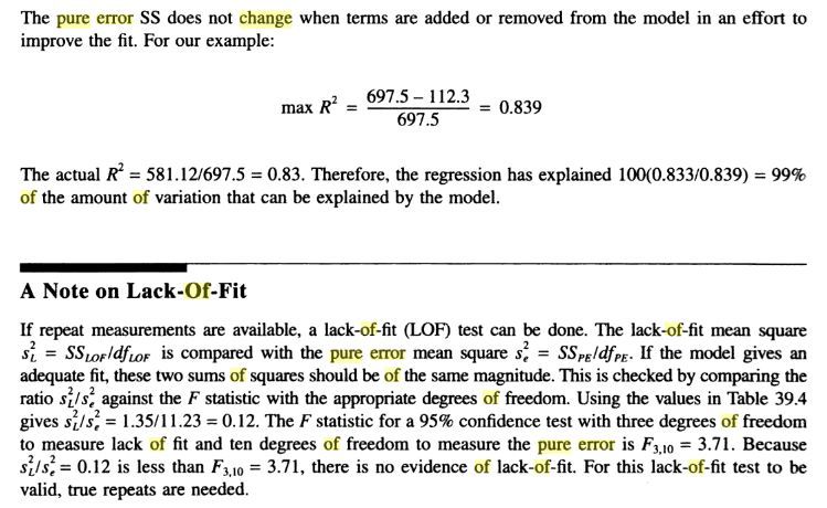

I think that DF of pure error is calculated from the number of pure replication so it cannot be changed while selecting different models.

The first model that you ran in both JMP and MINITAB includes A, B, C, A*C, and BC. The second model is A and B with JMP but only B for MINITAB.

You said that you used a 2^(7-4) regular fractional factorial design. This design is for the main effects model for 7 factors in 8 runs. You included 3 center points for a total of 11 runs. Your analysis shows that you have 19 runs so you either used a 2^(7-3) design or you replicated the 2^(7-4) design.
The DF for the LOF test are the same as the DF for the error SS in the AN0VA table. (Error DF = 13 in the first regression analysis.) The DF for the pure error are 1 less than the number of replicates. (Pure error DF = 1 DF for from each replicate FF design point + 2 DF from the replicate center points = 10.) The DF for the LOF is the difference between the two DF. (LOF DF = 13 - 10 = 3.) For the second case with just 2 main effects, the error DF = 16, pure error DF = 14, and LOF DF = 2.
As I said before, JMP is using all the DF not used by the model in an omnibus LOF test (any LOF). On the other hand, MINITAB is using more than one F-test for specific LOF components. They are different hypothesis tests so you can't expect them to be the same.

To be more specific about the claim by your source, that pure error SS is independent of the model, it depends on how the LOF is tested. The pure error and LOF DFs and SS are not independent of the model in the JMP test for LOF. The method presented in your source and (apparently) in MINITAB is model-independent.
The LOF test, however it is postulated, is a comparison of the model-dependent estimate of the random contribution (ANOVA error SS) to the model-independent estimate of the same (LOF pure error SS).

OK. I admit my mistake in getting the result in Minitab.
But my key question is how DF & SS of pure error in Lack-Of-Fit test are calculated and why they are different between softwares.
"Statistics for Environmental Engineers, Second Edition""Statistics for Environmental Engineers, Second Edition"

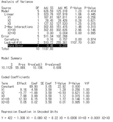

Re: Why DF of pure error of LOF test change when terms are added or removed from the model?

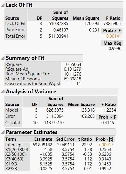

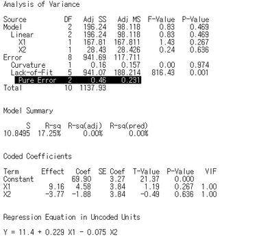

As you pointed out, there are several mistakes in my analysis. Sorry for confusion.
I posted correct analysis results.(2^(7-4) + 3 center points = 11 runs)
But the diffrence between softwares still exists.
The choice of the test is not based on agreement of the results or significance of these tests. Hypothesis tests are specific for the given alternative hypothesis, so the choice is based on the alternative hypothesis. JMP is testing any LOF. MINITAB is testing LOF differently.
