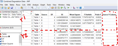

I've included code to take the name of the y-column for each loop and add it as a new column to each report and then concatenate each report to a new master table. The individual reports and the 'combinedDataTable' both have the new column ("Source Y Column"); however, it does not populate the cells with the respective column name. The script runs fine and without errors. I've included a number of screenshots below. The problematic code is toward the end of the script.

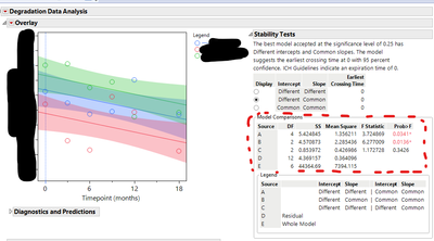

Here is the output window from one of the degradation analyses. I'm extract the information in the red outline.
 Here is the master output table that has both Y, responses but the 'Source Y Column' is not populated.
