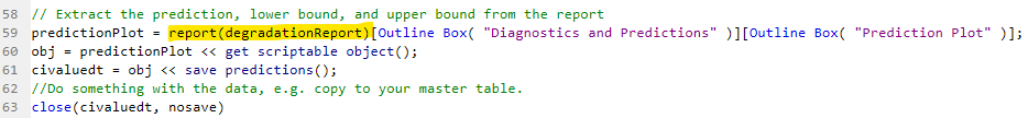

I believe there are some programming errors.

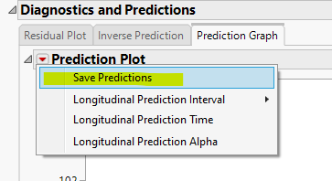

Following is probably what you need to do.
First on Line 59, you need a "report" call, wrapping around the object returned from platform calling. This "report" gives you a display true, which you can navigate using outline box subscription, etc.
On Line 60, it returns a scriptable object, to which you can send commands that you see in the drop down menu. Such as this:
Line 61, send such a command, as if you clicked the menu item.
Line 62, you do something with the numbers that you need.
Last, you close that data table without saving anything, because you have done with it.
