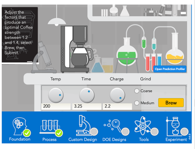

The second is the JMP DOE Introductory Kit. This will give you a good overview of the process of designing, conducting, and analyzing your experiment in JMP itself.
1580747517127
These are both really good resources to help get you started.
