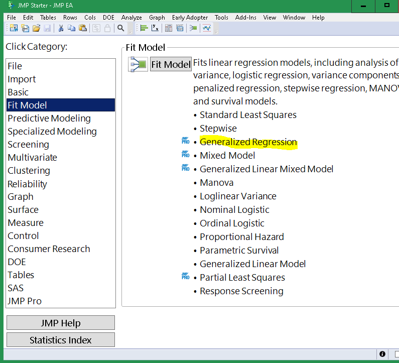

It is a JMP Pro feature.
The JMP Starter window in 17The JMP Starter window in 17

Thank you Craige_Hales! I thought I had the Pro version as all my headers say "JMP Pro" see original screen shot but it does not provide me with the additional tools in your screenshot.

Generalized regression, which is in JMP Pro, includes zero-inflated Poisson as an option.
