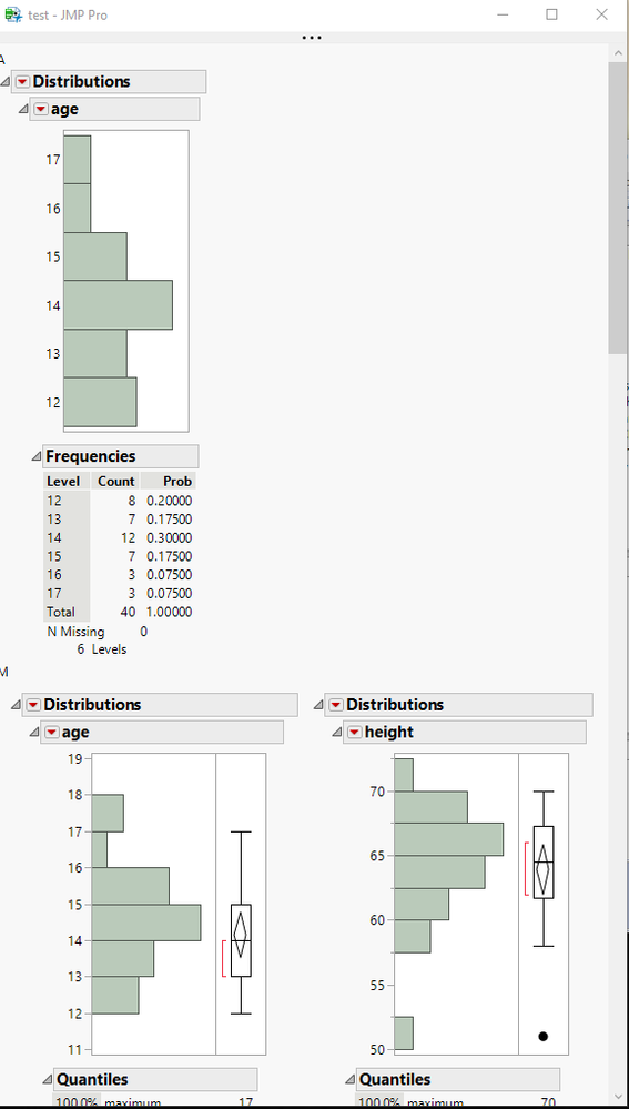

I have some code that is designed to build a report based on some filtering.  It will be fed two lists, the first will determine which materials get pulled (in this example that will be Gender_List), the second determining which properties get graphed (In this example that will be Property_List).   The idea being that there will be a loop through each Gender that will create a matrix of graphs for all selected properties.   There is also an over-arching, unfiltered graph at the top of the report
There are two ways to do this.
The first with intrinsic where clauses in the graphs.  I've mostly gotten this to work, except that the Where clause ends up taking up a position in the line up box. Also for some reason in the mockup I have below I have a bug that I don't entirely understand (my full version does not have that bug, but would still be curious if someone knows how to fix it).  Here is the mockup code

Definitely a major improvement, but it looks like I still have that hanging "where( :Sex == Gender_List[j]" clause showing up in the lineup box. Any idea how to kill that?

Still can't seem to figure out how to get rid of that "where" clause in the lineup box.  I switched it over to a graph builder object to see if header/footer preferences would remove it, but didn't seem to do it.
I've tried to re-write this a data filter wrapping the LB.  That has some advantages anyways as it allows some customization by the user.  This seems to work, however, as you can see it looks a little wonky because the Data Filter is incredibly collapsed.
