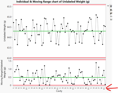

When I build Xbar-Range Chart in JMP 19Pro, it turns to IMR chart automatically, even I set the subgroup data.
Aug 7, 2026 10:13 PM(257 views)

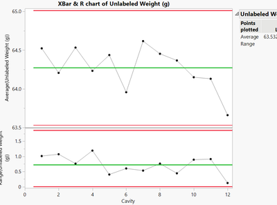

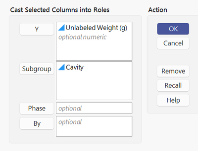

as the title. when I use the way to build XBar-Range Chart in JMP 18 it still works, but in JMP 19Pro, it turns to IMR chart automatically, even I set the subgroup data.

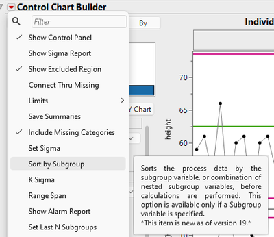

There are plenty off posts related to different sorting/grouping issues with control chart builder and JMP19. If I remember correctly, you have to enable this
