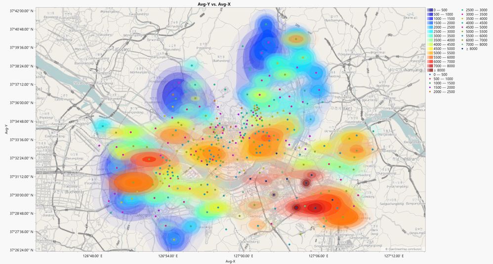

I am trying to map coordinate data from Korean Government into JMP; because the data set given is much bigger and has detail resolution of map.
However, I have no idea how to convert the X-Y Coordinate to Longitude/Latitude system as used in Google or JMP.
So far as I am aware, the coordinate of X-Y is given in EPSG:5174.

With application of real estate price in Seoul, I produced the graphic as below / yet I wish to convert X-Y into Long/Lat Axis.

I believe it should be WGS84. I converted those coordinates and got:
126.975687°, 37.5904772°
Does this location look like what you would expect?

Yes, I figured it out, but then I cant convert XY table into WGS84-(EPSG3857?) from EPSG5174 (what I have).
So I went up to a point where I downloaded QGIS and opened up SHP file and got that coordinate changed to EPSG3857 of which is used for OpenStreetMap that is also used in JMP Background Map as Street Map, yet I have no idea how to extract it to csv or similar. Is there any addins that can convert different map coordinates including z axis vector projectile to rectify elliptical aberration during conversion if any?

I think I got it sorted somehow.
1. Converted X-Y Geometric Coordinate from EPSG5174 (Korean Belt) to EPSG4326 (WGS 84 - World), by using QGIS tool
2. Set X-Y into Longtitude / Latitude Coordinate format
3. Checked if it matches with OSM (Open Street Map)
    * I am not sure of its accuracy, but for now this will do.
