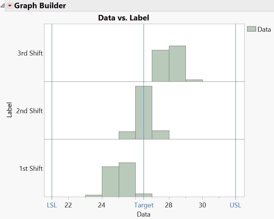

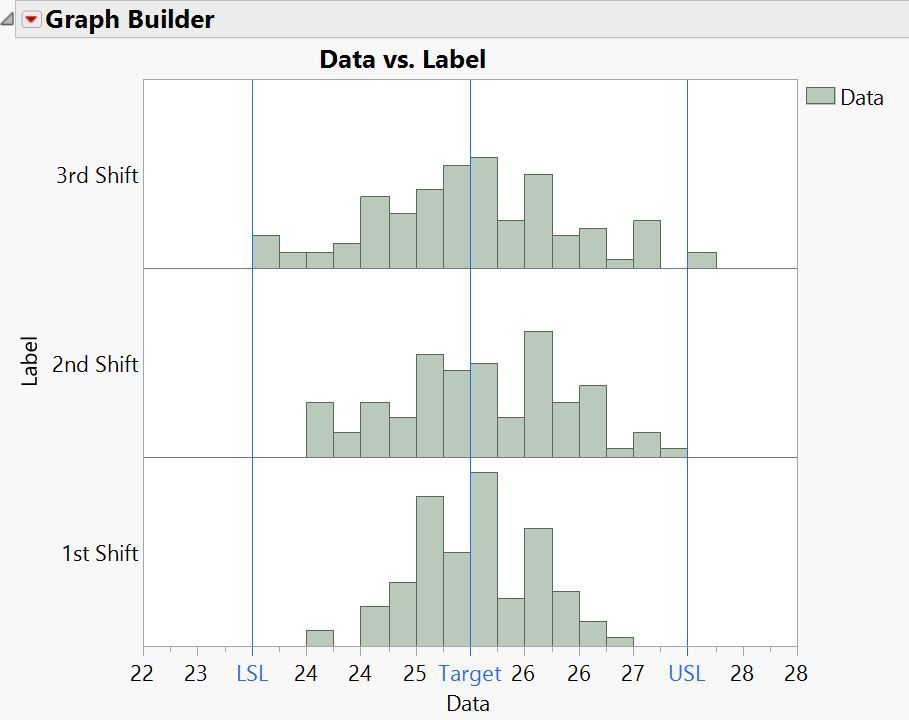

In addition to the invaluable comments from @txnelson and @P_Bartell, I would like to suggest to try for identifying the 4 processes behaviors by using the tools and/or techniques in the files, which I prepared based on specific scenarios, attached. Example shots are below.
