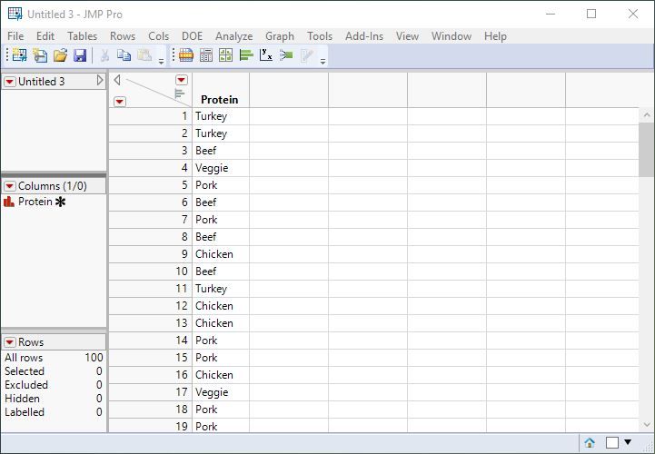

Here is an example with each observation of protein on its own row. (Row equals observation)

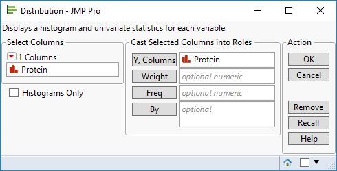

I can examine the distribution of Protein with this launch dialog without the Freq role.

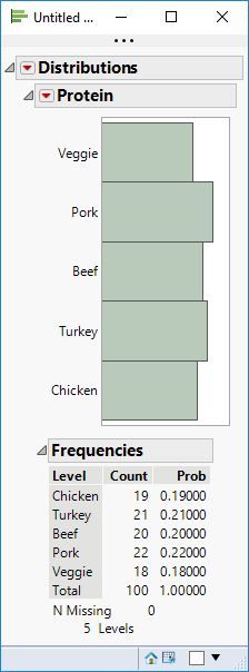

I get this platform.

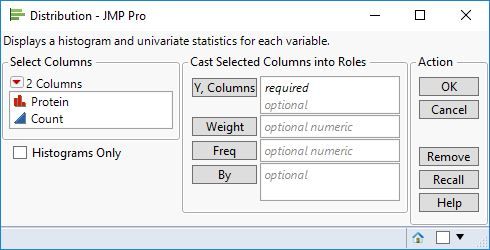

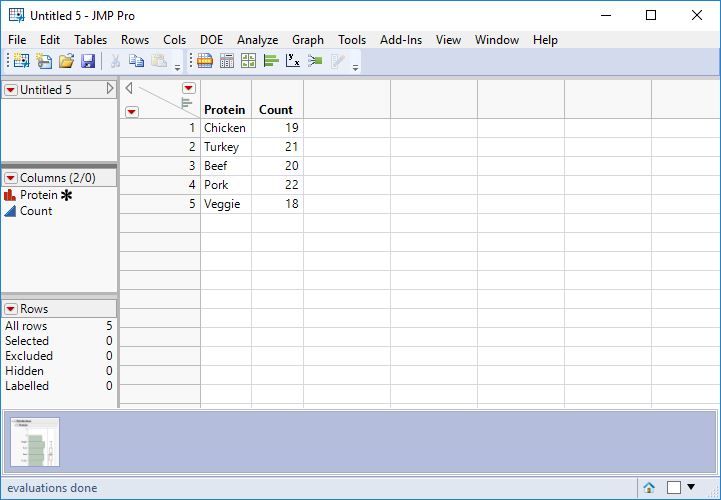

But sometimes the data is available as a summary.
I could manually expand this short data table (5 rows) so that each type of protein has the correct number of rows in a tall table (100 rows), but the Freq role does that for me internally.
