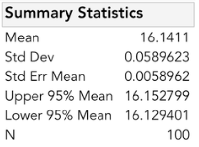

Here are the summary statistics for the data.

Thank you @Victor_G. It is very helpful! I have a follow question though. In this example, the sample size is 5, and there are a total of 20 subgroups which make up 100 samples in total. In this case, should I use 5 or 100 for n? Thank you.

Hi @DendrogramSteer,
In the example of STIPS course, there are 100 measurements of diameter values done in 20 subgroups (corresponding to machines used), and the sample size used here is 100 for the prediction intervals of the mean : we want to know, for any machines used, what would be the 95% prediction interval for the mean diameter for the next value : https://community.jmp.com/t5/Learning-Center/Calculating-Prediction-and-Tolerance-Intervals/ta-p/271...
But depending on your objective, you might calculate it with a smaller sample size : Suppose you know that the next piece will be done with Machine 3 (or you are only interested in results from Machine 3), you might be interested to calculate the prediction interval for the mean only for the pieces that were measured with Machine 3. You may in this case use the sample size 5 (for Machine 3) in your calculations and calculate the corresponding prediction intervals just for this machine (due to the lower sample size, your prediction intervals will probably be wider than those calculated with sample size 100).
