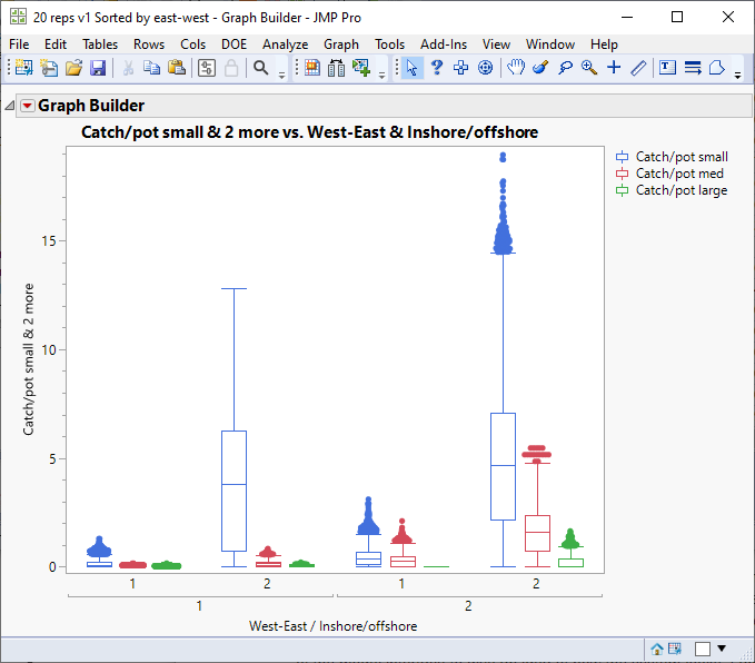

Here is one plot that might be useful:
I had to change the modeling type of a few variables to make them into groups. Also, I do not know the meaning of the 1 and 2 codes for West-East and In-shore Off-shore, but you can add the Value Label column property to make it clearer.

That's a really nice plot. I've long wondered how it would be possible to get not only the mean but also SD or SE plus range. Could you send me the script for it?
Re: What is the best way to graph catch/pot in relation to east-west and inshore-offshore vessel groupings?
You can use Tables > Summary or Analyze > Tabulate to get sample statistics. use the grouping variables and select the statistics for the catch/pot variables.
You can then click the red triangle and select Save Script when you have the results as you like.

Thanks. I realised after sending my message how to produce the graph. It's very simple as you point out!
