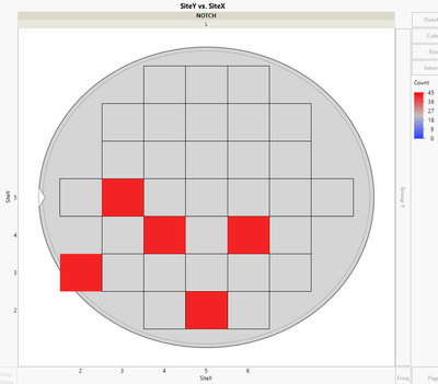

I have been drawing wafer maps in Graph Builder using Customize Graph.  One issue I have is that the custom outline I have remains static in the frame, whereas the die can move depending on where they are populated.
For example, if I only test a few die, their location appears to relocate to the bottom and left relatively to the drawing.
Aside from adding bogus data to occupy the previous extremities, is there a way to have the relationship remain fixed?  The code contained in the Customize Graph Script is as follows.
Transparency( 0.5 );
Fill Color( "Gray" );
Oval( -1, -1, 7, 7, 1 );
Pen Size( 2 );
Line( [-1, -0.855, -1], [2.75 3 3.25] );
Pen Color( "Black" );
Pen Size( 2 );
Oval( -1, -1, 7, 7 );
Pen Size( 1 );
Line Style( "Dotted" );
Oval( -0.9, -0.9, 6.9, 6.9 );
Transparency( 1 );
Fill Color( "White" );
Polygon( [-1, -0.855, -1], [2.75 3 3.25] );
Line Style( "Solid" );
Fill Color( 1 );
Rect( 1.5, -0.5, 4.5, 0.5 );
Rect( 0.5, 0.5, 5.5, 1.5 );
Rect( 0.5, 1.5, 5.5, 2.5 );
Rect( -0.5, 2.5, 6.5, 3.5 );
Rect( 0.5, 3.5, 5.5, 4.5 );
Rect( 0.5, 4.5, 5.5, 5.5 );
Rect( 1.5, 5.5, 4.5, 6.5 );
Rect( -0.5, 2.5, 0.5, 3.5 );
Rect( 0.5, 0.5, 1.5, 5.5 );
Rect( 1.5, -0.5, 2.5, 6.5 );
Rect( 2.5, -0.5, 3.5, 6.5 );
Rect( 3.5, -0.5, 4.5, 6.5 );
Rect( 4.5, 0.5, 5.5, 5.5 );
Rect( 5.5, 2.5, 4.5, 3.5 );
