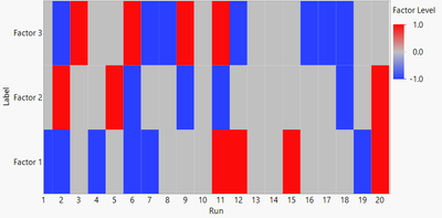

One silly solution could be to plot your factors on the y-axis, your run order on the x-axis and use a heatmap with factor level (-1, 0, +1) as color. I guess this could help you visually assess if there are any patterns.
