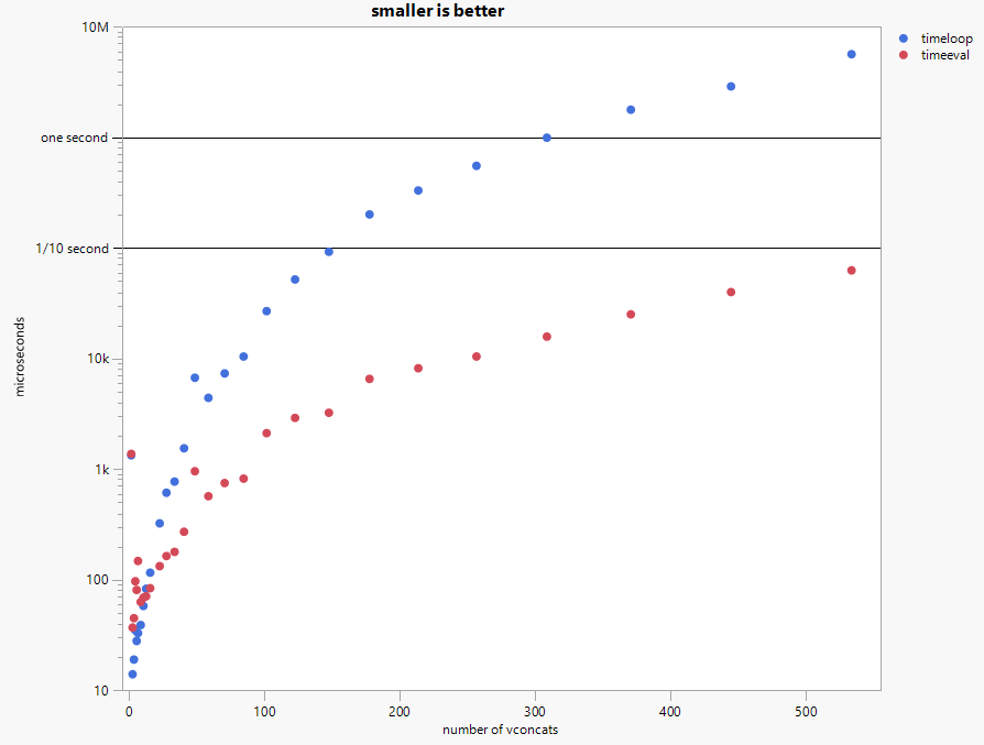

If you are concatenating 50 or more, you might not want to use a loop to concatenate them one at a time. If you already have a list of mats to concat, you can turn the list into a vconcat function like this:
	Substitute Into( OutputList, {}, Expr( vconcat ) ); // convert {a,b,c} -> vconcat(a,b,c)
	result2 = Eval( OutputList ); // evaluate the expression
The eval can be 10X faster than the loop:
JSL to make the graph:

Craige

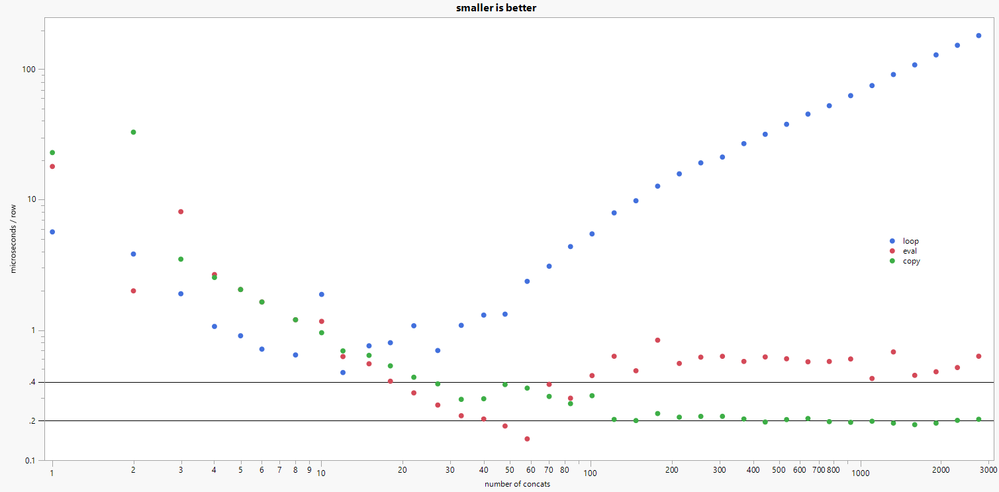

I reworked the graph to see the O(N) behavior and add a jsl loop that also achieves the O(N) behavior. The red, green, and blue curves now measure time per concatenated row. The red and green curves stabilize around .3µs / row but the blue curve is getting slower and slower per row copied for bigger and bigger problems because the blue loop recopies all of the previously copied data (and reallocates the matrix) for each mat added to the result. The last blue dot is 180µs * 3.8M rows, or 11 minutes. The red and green dots are ~200X faster.

For( N = 1, N < 3000, N = Ceiling( n * 1.2 ), // build a bunch of test sets of bigger and bigger sizes
	result1 = result2 = result3 = .; // clear previous run memory, if any
	OutputList = {}; // will be a list of matrices
	For( i = 1, i <= N + 1, i++,
  // do some calculations, generate a matrix of results, call it,  ThisM
		ThisM = J( i, 30, i ); // rows, cols, initial value. 30 makes this demo run in a reasonable time.
		Insert Into( OutputList, ThisM );
// copy... fastest, green in graph, O(N) behavior. Use the red eval below because it is simpler?
	start = HP Time();
	// find total rows and pre-allocate
	nr = 0;
	nc = N Cols( OutputList[1] );
	For( i = 1, i <= N Items( OutputList ), i += 1,
		nr += N Rows( OutputList[i] );
		If( nc != N Cols( OutputList[i] ),
			Throw( "bad cols" )
	result3 = J( nr, nc, . ); // allocate the result, exactly one time
	nr = 0;
		result3[nr + 1 :: nr + N Rows( OutputList[i] ), 0] = OutputList[i]; // copy pieces into the pre-allocated result
		nr += N Rows( OutputList[i] ); // position the next piece after this one
	t3 = HP Time() - start;
// loop is slower ... blue in graph. This exhibits terrible O(N^2) behavior--reallocates the result bigger and bigger
	start = HP Time();
	result1 = OutputList[1];
	For( i = 2, i <= N Items( OutputList ), i += 1,
		result1 |/= OutputList[i]; // this is the vconcat into operator. copies all the previous data into a bigger mat, each time.
	t1 = HP Time() - start;
// eval is faster ... red in graph ... last, because OutputList is modified. Easier than the green copy and same O(N) result.
	start = HP Time();
	t2 = HP Time() - start;
// capture the timings
	dt << addrows( 1 );
	dt:nmats[N Rows( dt )] = N;
	dt:loop[N Rows( dt )] = t1 / N Rows( result1 );
	dt:eval[N Rows( dt )] = t2 / N Rows( result2 );
	dt:copy[N Rows( dt )] = t3 / N Rows( result3 );
	If( !All( result1 == result2 ) | !All( result1 == result3 ) | !(N Rows( result1 ) == N Rows( result2 ) == N Rows( result3 )),
		Throw( "bug?" ) // they should be identical
	Wait( .1 ); // watch the graph grow
Craige
