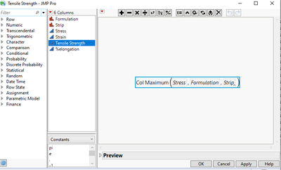

The final problem I'm trying to solve is the following: I have stress-strain data for multiple test strips for multiple formulations (please see the attached JMP data file). The attached table contains 4 different formulation+strip "groups" i.e) FormA/strip1, FormA/strip2, FormB/strip1, FormB/strip2... For each group, I need to identify 1) the maximum stress (tensile strength) and 2) the strain associated with the maximum stress. To identify the maximum stress, I created a column "Tensile Strength" and used simply used "Col Max()" in the Formula Editor (see image below)
Now, I'm looking to populate the "%elongation" column with the strain values associated with the maximum stress (tensile strength) for each group, and this is where my issue lies. Rather than going through the table to manually identify these strain values and populate the "%elongation" column, I'm wondering if there's a way to accomplish this with a column formula (or JSL script).

txnelson
Re: Using loops in formula
Here is a formula for the creation of %elongation.  It is not a very efficient formula, but it will find the value regardless of the order of the data.
curForm = :Formulation;
curStrip = :Strip;
theRow = (Current Data Table() << get rows where(
	:Formulation == curForm & :Strip == curStrip & :Stress == :Tensile Strength
))[1];
:Strain[theRow];
If the data are sorted by Formulation and Strip, then the more efficient formula below can be used.
If( Row() == 1 | :Formulation != Lag( :Formulation ) | :Strip != Lag( :Strip ),
	curStrip = :Strip;
	))[1];
:Strain[theRow];
Jim
