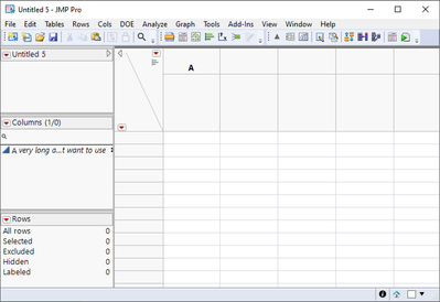

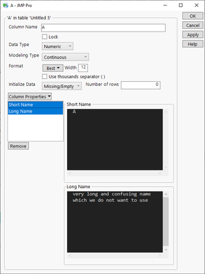

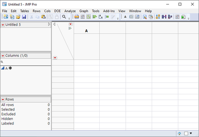

Alternate column name might work? https://www.jmp.com/support/help/en/17.1/index.shtml#page/jmp/preferences-for-data-tables.shtml  . It is extremely confusing how it works and it won't allow you selecting which to use though (it is either one or both). But I think you could set your column name to your symbol and then add two properties, Short Name and Long Name, and set those values.
This one creates a table with "long" and short name. Change the preference value to see how those behave

Yea that is very confusing. Had to play around with it. So as far as I can tell, you have to have the same string in the column name and either of the short or long name (or, incedentally, both). If all three are different, then it fails. Seems to be a rather round-about way to do it when you could easily have just a bunch of names (even a list, like the value order property is set up). Kinda weird.

Pop up at the top of column? Do you mean by the side? I enabled the preference "Show Alternate Column Name"
One fairly nice thing is that the long name can be seen when column header is hovered over (if that setting is enabled). It can also show note separately
