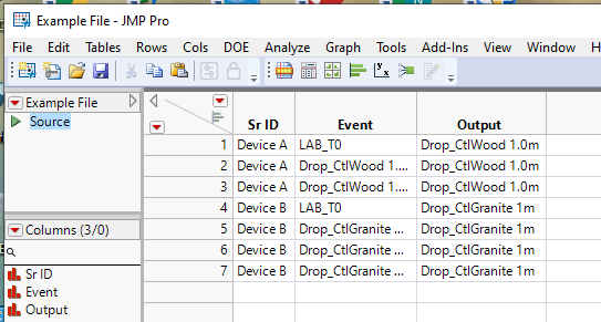

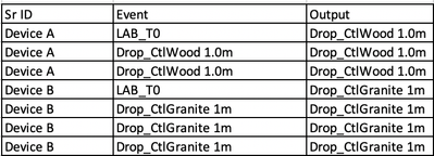

Request some help with scripting the "Output" column.
I have a list of Sr IDs allocated to different events and need the resulting output column where LAB T0 event is matched to specific Event
Would be obliged for the help. I have attached the excel file for the above screenshot.

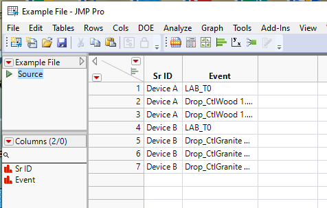

Given a data table that looks like this
JMP provided the following script as I interactively when through the steps to create your required output
// Clear row selection
Data Table( "Example File" ) << Clear Select;
// Data table summary
// → Data Table( "Subset of Untitled 9 By (Sr ID, Event)" )
Data Table( "Example File" ) << Summary(
	Group( :Sr ID, :Event ),
	Freq( "None" ),
	Weight( "None" ),
	Link to original data table( 0 )
// Select matching cells
Data Table( "Example File By (Sr ID, Event)" ) <<
Select Where( :Event == "LAB_T0" );
// Delete selected rows
Select Where( :Event == "LAB_T0" ) << Delete Rows;
// Delete column: N Rows
Data Table( "Example File By (Sr ID, Event)" ) << Delete Columns( :N Rows );
// Change column name: Event → Output
Data Table( "Example File By (Sr ID, Event)" ):Event << Set Name( "Output" );
// Update data tables
Data Table( "Example File" ) << Update(
	With( Data Table( "Example File By (Sr ID, Event)" ) ),
	Match Columns( :Sr ID = :Sr ID )
