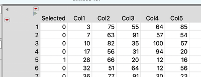

Inspecting the formula will show us what is happening here. Below, I've made a table and done the same thing you did: I selected row 5 and then installed a 1-click "selection" column on row 5. Note this currently corresponds to the row whose value is 28 in col1.
Upon deleting row 2, just as you mention--row 5 still has a 1, but this is not the row whose value is 28 in col1.
Double-clicking the "+" to the right of the Selected column in the Cols pane, we see an image telling us the formula contains a 15x1 matrix, indexed by the row() function.
Double-click this image to see the formula itself:
This formula is always going to place a "1" in the 5th row, as the 1 is hard-coded into the matrix. In fact, change some of the zeros to ones and you'll see that now, other rows are also set to "1".
It does not matter that our table had 15 rows when we started and now has only 14 rows... any rows in the matrix with a "1" will receive a "1" in the table, as long as the row exists.
