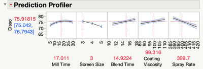

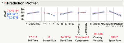

The prediction profiler is an excellent interactive tool for making sense of a model from a physical standpoint. A great example demonstrating this can be found in JMP’s Help->Sample Data->Industrial Experiments->Tablet Production.jmp example. Run the Fit Model and Fit Model with Interaction Profiles scripts and observe the difference between the two models.
Main Effects model:
Main Effects+Interactions+Quadratic model
In the 2nd Profiler, observe the Mill Time variable showing the effect of introducing a quadratic effect on our model. As you adjust the Mill Time value from 5 to 30 you will observe the physical impact of this term on our model: a peak in our Disso response between the two extremes.
This is in contrast to the Main Effects model where we see a linear trend, leading us to expect improving performance in Disso as we increase Mill Time.
